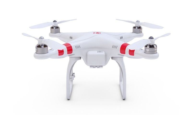

Basic Parameters
Operating Temperature-10°C ~ 50°C
Power Consumption3.12W
Take-off Weight<1200g
Hovering Accuracy (GPS Mode)Vertical: 0.8m
Horizontal: 2.5m
Max Yaw Angular Velocity200°/s
Max Tilt Angle45°
Max Ascent / Descent Speed6m/s
Max Flight Velocity10m/s
Diagonal distance (motor center to motor center)350mm
Phantom Prop GuardWeight(Single):18.7g
Size(Single): Angle(155.0°) Radius(112.32mm)
Whole Size with Four Prop Guards: 575.5mm
